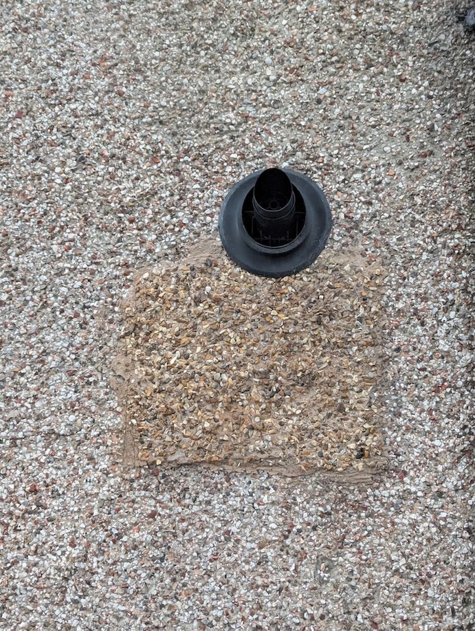

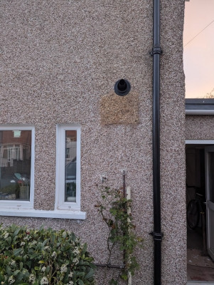

Previous owners of my house filled in patch of pebbledash with wrong coloured stones.
Is there a way I can white wash/paint this patch to make it match the colour of the surrounding pebbledash? Please see photos.
It has been like this for atleast 5 years so its not going to fade.
No.
You would need to colour match and paint each individual stone, obviously that is not going to happen.
