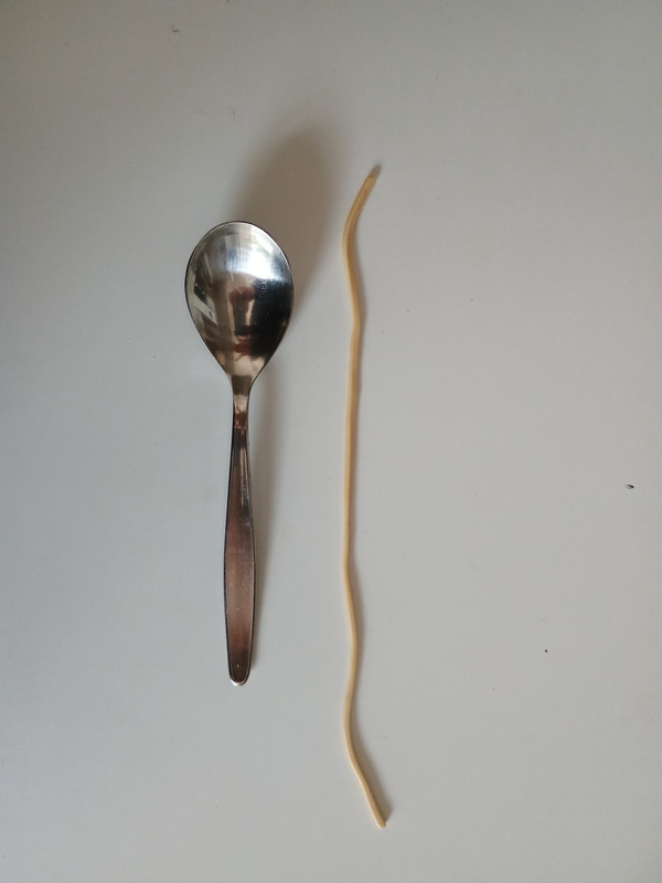

My mum's Miele dishwasher (G1225 sci) was tripping the fuse when started. I tried to give a good clean around the filter area and impeller, and eventually found some glass shards (though not in the impeller so I don't think they were blocking anything). Eventually we realised that the fuse only seems to trip when running the "Automatic" program; the fast 40° and Intensive 75° programs seem to run. Any suggestions?
Also, when I took a look at the impeller, I found a long rubber seal that was just hanging out; I am not sure where it came from, or how to put it back. I'm worried that running the dishwasher without the seal will just cause additional problems, so any ideas of where it goes would be appreciated.
The dishwasher is quite old so calling out a plumber here (she's in Germany) probably won't be worth it given the call-out fees alone.
Seal:
