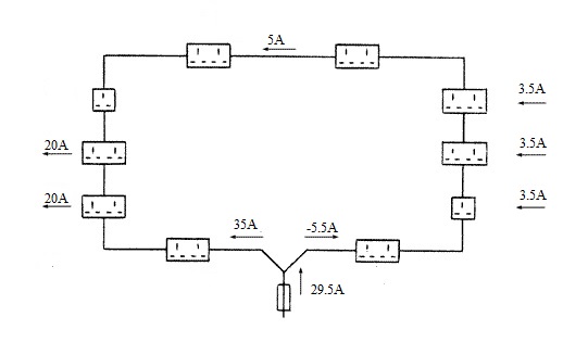

I see we are now permitted to use plug and pray solar installations, but I can't find out what, if any, British standard they need to comply to? Three electrical questions, one what stops cables being overloads as shown in picture, what happens if 4 solar units are plugged into an extension lead, will they auto disconnect as the extension is unplugged, or will they island? And can you get paid for export, assuming you don't already have a second MPAN number.
