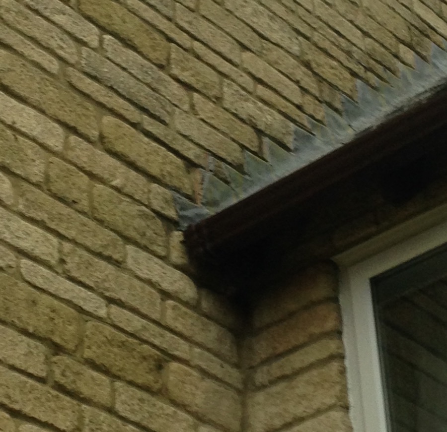

I have a damp patch that comes and goes in the corner of my bedroom. The patch does not appear in the summer or when we have warm rain.
However as soon as the temperature drops outside the patch reappears. The patch mainly appears overnight and disappears again during the day as temperatures increase.
What is causing this and how do I remove it?

Outside of the house. Damp patch is on the main wall connected to the flats.

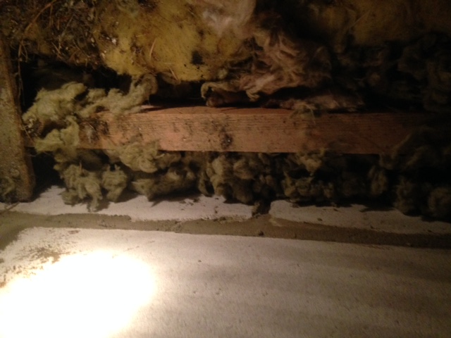

The damp patch is more likely to be condensation than a leak. It appears when the walls are colder because the warm air is hitting a cold surface and condensing. See our project page on condensation here https://www.diydoctor.org.uk/projects/condensation.htm
When the walls warm, the air does not condense. Bingo - no mark.
Ventilation required to stop this happening

Based on that should the insulation above be in the gap between the wall and wooden rafter.

Based on the above post, should there be insulation between the wall in the attic (attached to next door) and the wooden beam or is this leading to the poor ventilation.
Underneath insulation showing wooden beam and wall.
