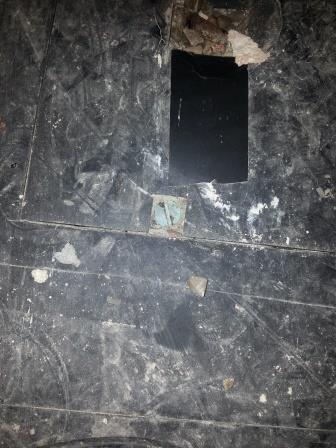

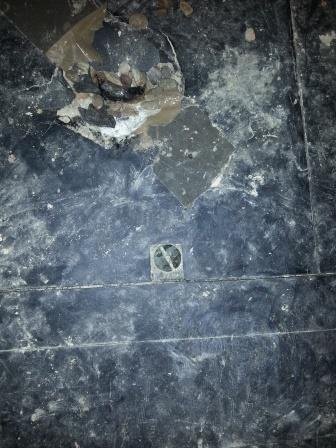

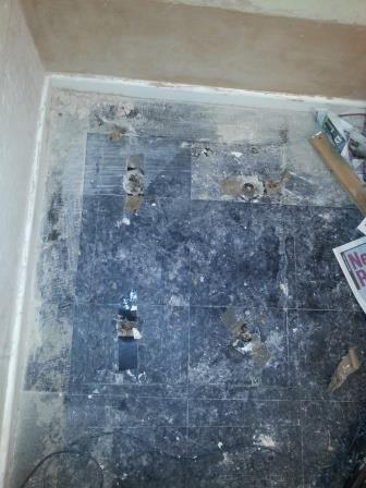

We think the cause was condensation rather than rising or penetrating damp; just a cold room where previous occupants may have dried clothes etc. However, taking up the carpet revealed an internal drain cover, fitted by a previous owner, where two out of four corner screws have corroded and gone greenish.
Question: Is the screw corrosion due to the damp underlay and carpet from condensation, or due to damp rising up from the drain below either around the screw holes or the cover seal?
Hoping it's not rising damp, but prepared to replace the cover with a new double sealed one if necessary, or as a cheaper fix, apply silicone around the existing screws and all around the cover seal if that made it rising-damp tight.

Less corroded screw
Less corroded screw
Most corroded screw
Most corroded screw
Internal drain cover, iron hooks near corner screws

If all walls were affected its very unlikely to be rising damp and almost certainly condensation. Check for an old leak to a radiator for cause of floor damp on screws to manhole cover. This could alse be caused by heavy condensation seeping into carpet although in both cases a lack of a damp proof membrane under the floor slab cannot be ruled out until properly investigated. The damp returning to the walls in a properly ventilated ròom will be a sign that its damp rather than condensation.
