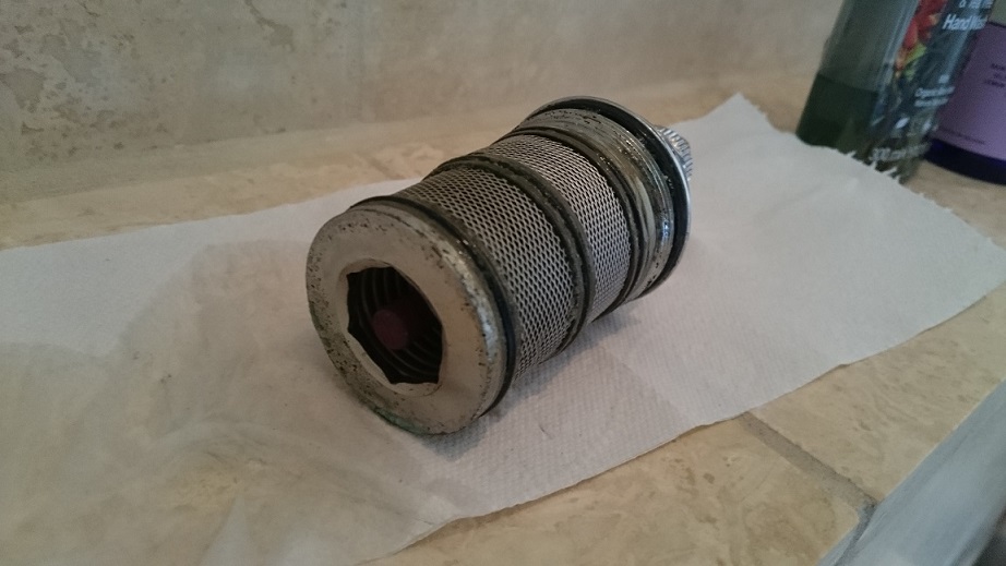

Hi, I need a new thermostatic cartridge but don't know the brand. Can anyone tell from the pictures? Thanks very much in advance.

I've just fitted one,am due to go there again,will try and find out for you

The instruction leaflet never had a manufacturers name on it,sometimes they do this to make it look exclusive to Victoria plum in this case,so you can always contact them,took details from sticker on the box VAL1003 TRIPLE VALVE and a phone number 0121334159100 which with any luck might be the makers number

Here is what the cartridge looks like:

Thank you for your help. That Victoria one was very similar. I think I have found the exact one. It is a Bathstore Quatra, and the valve is made by Crosswater (CP000250).
http://www.bathstore.com/products/quatra-vertical-thermostatic-shower-bath-valve-1729.html
Thanks again

Anyway, that's definitely CP0000250 - https://www.divapor.com/spares/showers/thermostatic-cartridge/thermostatic-cartridge-for-crosswater-cp0000250-gp0000250.php
