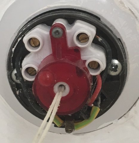

Original cord pull connections:
Old cord pull
Old cord pull
Black and red wires go into both IN terminals and the right hand terminals.

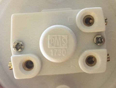

New cord pull connections:
New cord pull
New cord pull
How do I wire up the new cord pull?

Difficult to see if you have two red cores in the first picture.
I will assume you have!
The existing pull cord is a double pole switch, meaning it isolates/switches both line and neutral conductors.
The new one you have, is single pole only, to copy the existing wiring you require a double pole switch.
