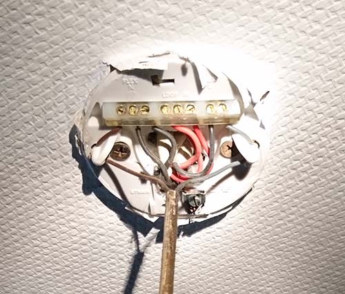

However you don't have any switch wires shown, there is no reason that the triple and earth should not go to the ceiling rose and in the ceiling rose you have an extra connector for the com, but since no picture of the ceiling rose we don't know what colour cable has been used for com.
So look in ceiling rose, the com does not connect to lamp. So L1 and L2 go to line supply and line to lamp if they are swapped it does not matter, com goes only to com on the other switch, and with an intermediate switch to the terminal on its own.

i have added picture of ceiling rose for middle landing.
Hope that helps

[img]http://www.ericmark.talktalk.net/pictures/two-way-plus-inter.bmp[/img] I have posted a diagram, as to if this will work not sure.
