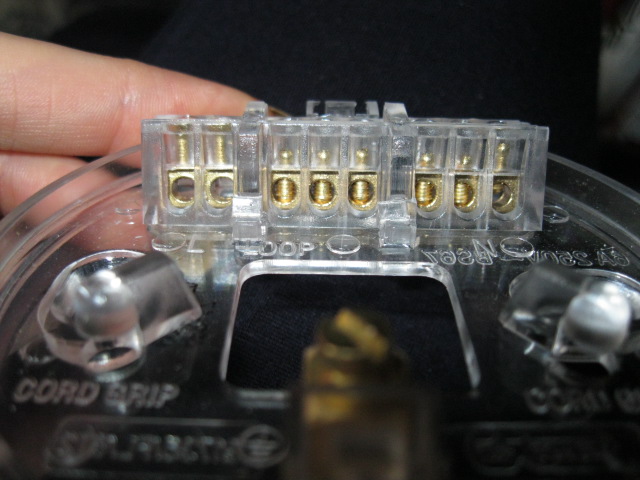

I think I may have to take the whole base off and put the new ceiling rose base on and reconnect all the wires. The problem is that I've just had a look at the new base - I thought I'd carefully loosen the little terminal screws in case I needed it. And I can't loosen 5 of the 8 screws at all. I can loosen the two in the lefthand L block, and the far right of the three in the N block (the screws that would correspond to the two for the light and the switch live?), but the other five screws appear to be fixed - the central 3 Loop screws and the first two of the righthand N block.
Have I bought the wrong base altogether? Or can I just not use a screwdriver?
I'm very sorry to ask daft questions, I just don't have anyone else to help. I've uploaded a couple of pics of the new base from the ceiling rose. If I've bought the wrong type, what should I ask for instead? Any advice hugely appreciated, thank you!

The ceiling rose you have purchased looks acceptable to me. Often the screws are tightened by machine, why not hold a screwdriver on the terminal and turn the rose instead?

Mr White wrote:The ceiling rose you have purchased looks acceptable to me. Often the screws are tightened by machine, why not hold a screwdriver on the terminal and turn the rose instead?
Thank you very much for the reply, Mr. White. I tried everything but they just wouldn't budge and I was worried I'd damage the screws (or the screwdriver tip) and I was beginning to wonder if there was another type of ceiling rose for old-fashioned wiring like I have and that this one was something new-fangled for people using those little block connector things (?). But later today I gave the rose to a friend and after 10 minutes of huffing and puffing he managed to loosen one of the middle screws. He's a big bloke, too. I guess they're just not very friendly for people without much in the way of muscle.
Happy ending, though - I managed to get the tiny over-worked screw out of the base on the ceiling and after much finickety fiddling and dropping the screw about a hundred times, I managed to get it to thread and hold the brown L pendant wire. I was too scared of dislodging it to pull it into the cord grip, I just screwed the cap on quickly and ... well, it works, so I will happily take that! It's just a bald light bulb (cant risk the weight of the shade on it) but I'm just relieved to have a functioning bedroom again so I'm not fiddling anymore! I presume the old light had just finally died and the actual wiring is hopefully still sound. I'm hoping that replacing the light means I no longer run through light bulbs at the rate of about one a month. They'd been blowing quite regularly.
