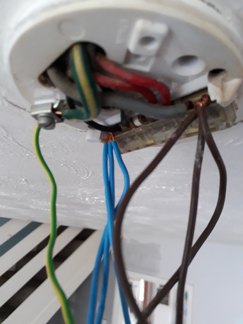

This is a picture of the rose

For some reason the image wasn't uploading. This is the current ceiling rose and we need to take it out and install the new light
Ceiling rose

Mark the cables with an indelible pen, take a couple of clear in focus pictures, then use "Wago connectors" (Get them from screwfix / electrical wholesaler) and use those instead of a ceiling rose, and if you put them in a wago box, you can poke the lot up into the ceiling, so you will only be left with a 3 core flex (That you purchased with the wagos) that you connect your new light to.
