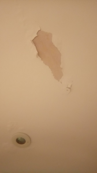

I treated the mould on my bathroom ceiling and it looked great for about a week until the paint began to blister and now it's finally started to peel away leaving a section of bare plaster.
Please advise me on what I need to do to, a) stop this happening again, and b) tidy up the mess I've made.

Scrape of all the loose paint until you get to hard edges apply a coat of stain block, lightly fill patch and sand and touch in with stain block and then repaint your ceiling
