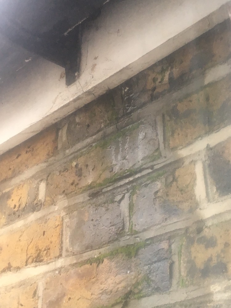

Basically, we've had an ongoing leak from our tiled roof down the outside of our wall (see picture). This is causing the paint inside the house to bobble.
I have had a go at trying to locate the leak last summer and even replaced some of the guttering but it still seems to be there. It looks as if it's either running behind the fascia board or on top of it.
I have been told that it could be because of a mislaid roof tile but any advice here or ideas would be greatly appreciated. I can take some further pictures of the actual roof if needed.

Hi
It would be very useful to view photos of the eaves detail. This is the section of roof that that runs into the gutter.
Without the benefit of photos of the roof, I would hazard a guess that the first course of slate/tile do not go into the gutter in this particular area.
