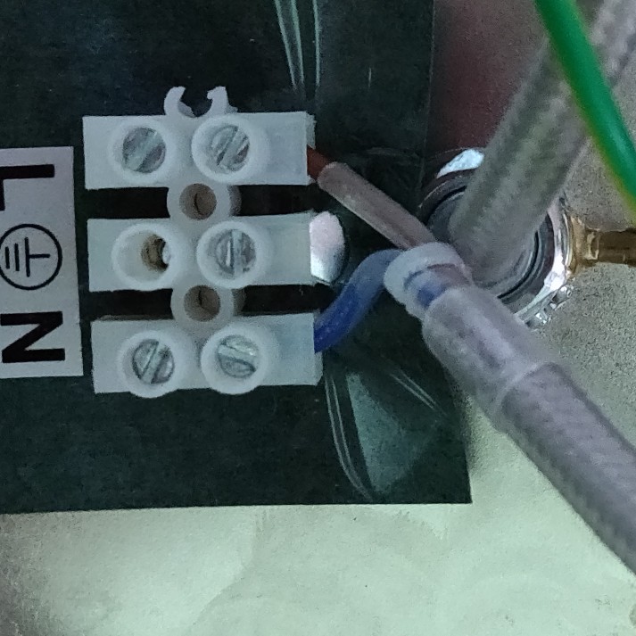

Thanks for your reply Mr White. I've attached a picture of the old fitting, which I what I'm used to with fitting light. Each wire has its own connector. Am I right in thinking I'll need to change the block on the new light?

It's hard to tell from your picture the physical size of the new light's connector block, so all I can say is try to connect the cables and see do they fit, if they don't then yes you will need a bigger connector block.
You could, of course, use Wago connectors, but for a one-off job, they are a bit costly.
Well done you for taking a picture of the ceiling rose before you disconnected it. Often people say ..............I have these wires where do they go?

Thanks for all your replies. I've got it sorted, it was the lights fittings that there me, it's a cheap light with a small connector block. I used wago connectors as I had some from some other jobs. It's all working which is great!

Just remember, do as you did before, take in-focus pictures, and you may want to mark the cables too.
