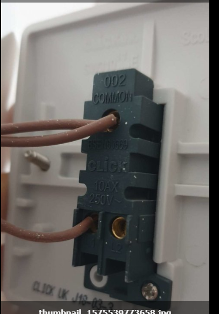

Hi everyone, Basically, I am planning to replace the light switches in my new build house with smart switches and as the switch has WiFi built-in it needs constant power to work so will require a neutral wire I've pulled the back of the existing lightswitch and have a "Common" and "L1" 2 x Brown wires in Comm 1 x Brown wire in L1 would anyone be able to let me know if there was a neutral cable installed in the light switch? I have attached photos of them here. I notice the x3 blue cables with a cap on the end, would this be the neutral wire and if it is, will I need to plug all 3 of them into the new light switch? Thanks in advance.

I suspect the three blue wires in the wango connector are neutral, however you will need to check.
Likely you will need to connect all blue wires, some times however the wires are brought to the switch for you to use but not connected up, I suspect they are connected but can't assume.

You are lucky, the blue wires are the Neutral your new switch requires.
I would suggest you label the BROWN wires, and take another picture (With the labels clearly in focus) You may need this at a later date.
The "cap" as you called it, is actually a Wago connector. If you look carefully it has an "unused hole" with the electricity OFF push a blue wire into the unused hole and connect the other end to the Neutral of your switch.
Then you can connect the brown wires of your switch to the correct terminals (You did take that other picture didn't you)
Once done, carefully put the switch back, make sure you don't catch any wires, then switch the mains back on and learn your new switch to your network.
