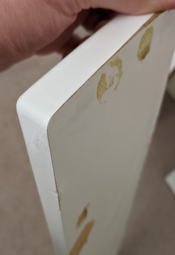

Hello,
Can you please help me identifying which type of the board is on the picture?
I had spillage in my bathroom and 2 panels of the vanity unit got swollen (I do not know the manufacturer unfortunately). I would like to get a replacement panel, but have no idea how it is called. Is it acrylic MDF? Or PVC?
Do you have any advice where I can order similar panels from?
Would greatly appreciate any help. Really upset about the situation and want to get my shiny bathroom back.
Kind Regards,
Igor

by stoneyboy » Sat Aug 15, 2020 9:30 pm
Hi igork
They look like purpose made mdf panels with a plastic coating. You could try on of the worktop shops and see if they can source replacement panels..

by andywarrick89 » Tue Mar 07, 2023 10:43 am
Hi Igor,
I highly doubt you'll be bale to pick that up off the shelf anywhere.
You'd have to go to a merchant or workshop with cutting services, buy some 25mm (I think - give it a measure) moisture resistant (MR) MDF, get the corners bevelled and give it a paint.
It's almost impossible to match without knowing the make/model I'm afraid.
