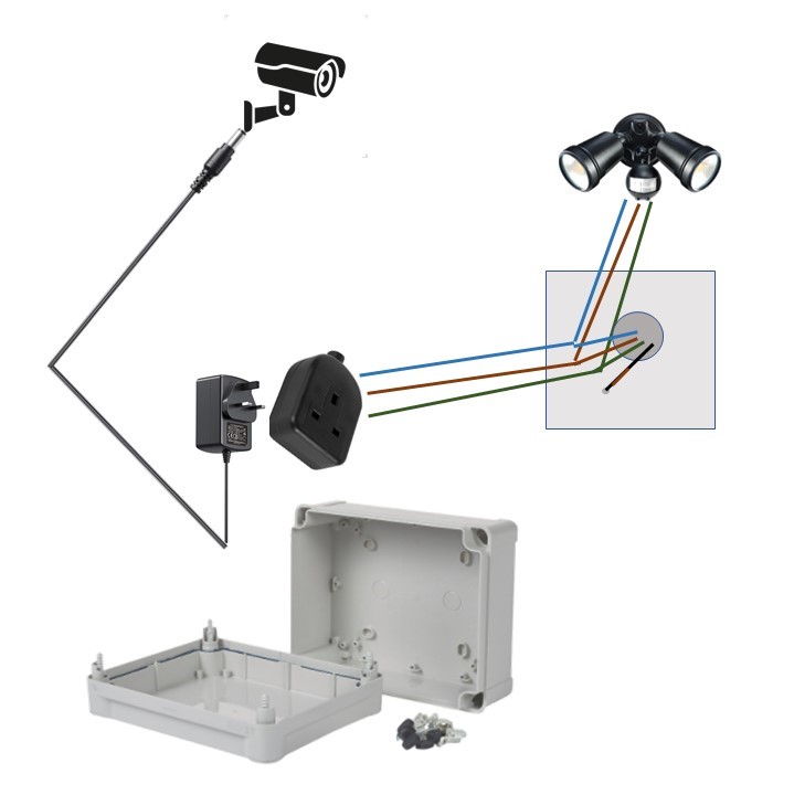

To answer Mr. White's question, the light is with a motion sensor and the switch is always ON. Also, there is only one cable with 4 wires (Live, Neutral, Earth, and a Black wire with a Brown sleeve). I've checked the outdoor sockets and yes you are right, the dc power adapter does fit in. Instead, if I use a 1 gang extension socket connect to the light fitting and plug in the DC power adapter and enclose it in a weatherproof box and fix it to the wall? will this setup work? Please check the attached picture.
By the way, I don't want to drill into the wall to extend the power adapter cable. I tried but failed.
Appreciate your help and thanks.

So long as you connect the socket correctly, it will work.
I would also suggest that you drill very small holes in the adaptable box on the surface that will point downward. This is to allow the box to breath and prevent condensation build up.
Where ever you plan to mount the camera, unless you are going to mount it on the front of the box, bring the cable out through the bottom, as a hole in the top or side will let the rain into the box.
