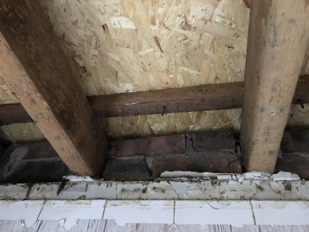

by Aktinidia » Sat Nov 06, 2021 4:11 pm
Thank you Stoneboy.
It looks like there is no ventilation under the roof. Brick walls all around and no air movement even on a windy day like today. (Please see attached photo)
Can I use insulation (rock wool?) in-between the joists and water-resistant plasterboards attached to the underside? Do I need to cover the plasterboard vapour barrier?
I already had two tradespeople suggesting very different approach. One suggested rock wool between joists and plasterboard underneath, the other nothing in-between joists and only insulation boards (Kingspan) under the joists.
Which approach is better?

From your picture I would assume you have a fall away from the main house roof. I suggest you fit insulation between the joists leaving say a 50mm gap above and a further layer of insulation with foil face with taped joints overboarded with plasterboard. Also fit vents in the facia end to give some air movement - this is important because it is a bathroom and you won’t want condensation in your new roof.
