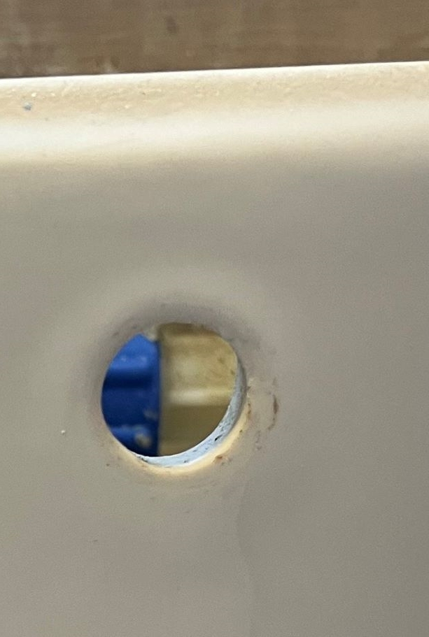

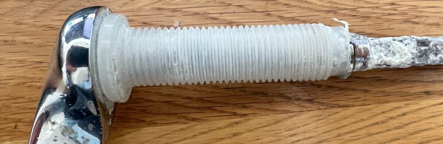

I am changing the syphon on my toilet and have run into a bit of a problem. The current handle and the cistern have a circular fitting but both of the new units I have tried have square fittings. Can anyone suggest a kit that would fit?

Have a look for flomasta, fluidmasta or Thomas Dudley plunger type flush units.

Fantastic. Thanks.
