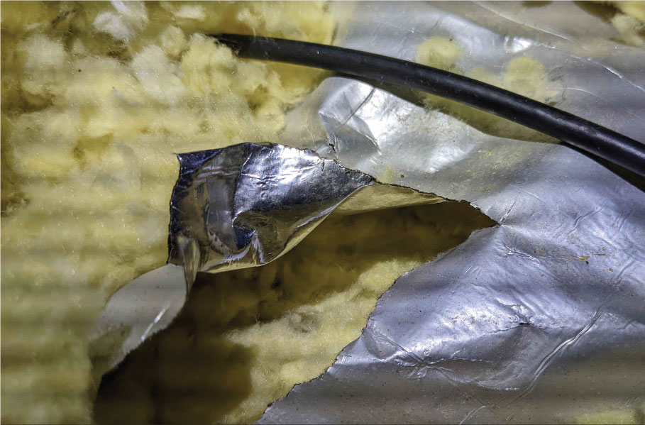

Mold found on top of insulation that's in contact with the vapour barrier.
Do I treat the insulation with anti mould spray or replace it?

by Red_48 » Sun Sep 18, 2022 5:27 pm
Correct, the mold is on the top surface of the insulation (which is dry), directly in contact with the radiant barrier.
I have not yet started to add insulation so this mold was present before.
I discovered it whilst installing a bathroom extractor fan and will assess the extent of the mold growth tomorrow. The pictures are of the insulation directly over the shower.
However, the whole house suffers badly in the winter with condensation (>70% RH first thing in the morning), and I'm considering this might be because the warm wet air can't escape through the radiant barrier (RB) installed.
I'm considering removing the RB but, with loose fill glass fiber blown over the top it's going to be messy and I don't know whether to spray anti-mold on the affected areas or pull it all out.

by stoneyboy » Sun Sep 18, 2022 10:16 pm
Hi red_48,
Thanks for the response and the pictures. I agree with you that removing the vapour barrier is Important. Cut it in sections and tip the loose fill off. The mould will just die once it no longer has a damp environment so longer term I don't think it will be detrimental.
