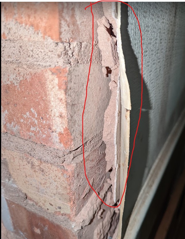

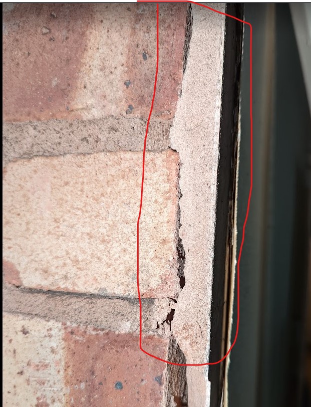

What is the material on the brick wall?
I'm looking to replace it but not sure what is it is.
I was thinking plasterboard but appears too thick for it to be plasterboard

Hi hbthefirst,
It could be any of the base coat plasters, most likely browning if it's an old wall, hardball if it's relatively modern.
Try scraping it with a screwdriver, if it is very soft it's browning.
