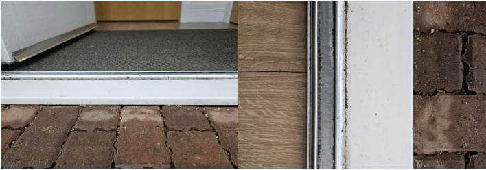

I suspect it is coming in via the front door, but there is no visual evidence of water ingress anywhere - however, walking around there is a very audible sloshing under the floors. But the flooring itself (including carpets) is bone dry.
I've tried calling a few damp specialists but without visual evidence of water they can't do much. The original builder (big national company) doesn't want to hear it as it's out of warranty. NAHB won't look into it without visual water damage - so I'm on my own for now!

I've investigated for cracks, poor/broken sealant, any way the water can get in but can't find any. I removed the blocks at the threshold and concrete is still intact with no obvious damage or cracks.
If I move aside some of the gravel at the side, there is some plastic membrane you can just about see.
The garage (white door on left) which is at a lower level than the front door is completely bone dry, even during heavy rain. There is no pooling of water on the lockblock either. Everything is very level (build to wheelchair standards).

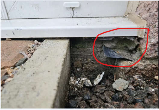

The picture below is the DPC(?) sticking out. Possible that water is collecting on that and being channeled on top of the membrane?
On the left side the DPC is folded down, although at the top still looks a bit wet/greenish whereas directly under looks dry?

Hi b0ng0,
The fact that the sloshing gets further into your house when it rains heavily links the issue to rainwater ingress.
It’s likely that your floor construction is block and beam with a membrane directly below the top layer of the floor covering - probably a screed. If you are saying that you can hear squelching when you walk across the floor then it is likely that there is some defect with the construction in the front door area.
You must eliminate the possibility that ground water rises in the front door area. If this is not the case it could be that the DPM has been taken under the front door allowing water to be fed into the house. The question is where does the water go once it is under your floor screed?
