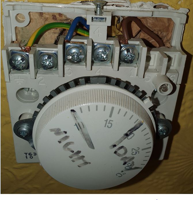

Old boiler had a physical timer-clock on it, this was controlled by a simple dial thermostat downstairs. Boiler broke down and had to get in replaced with a Worcester Bosch Greenstar. Installer did mention about thermostat, but I thought the boiler itself would have a timer function (maybe I was more concerned about how much it was already costing me thus far!) and decided to stick with the dial.

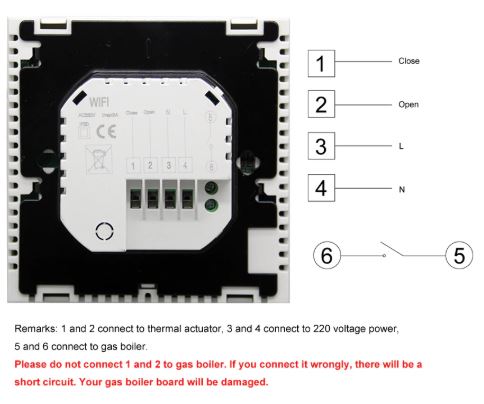

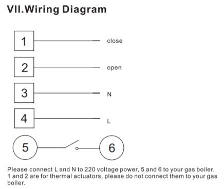

It's nice to have a working boiler, but not nice waking up to a cold house every morning! A friend recommended the Beok BOT-313 thermostat. I'm stuck with how to replace the dial one with this one.
I've attached images of the dial and the wiring, as well as the wiring installation extract from the Beok manual. The L to L and N to N seems straight forward, but it's how to engage the switch which has snookered me.

It seems you have no neutral so to use that thermostat you need to wire in a neutral, Flomasta 22199SX Wired Digital Programmable Thermostat Screwfix number (6259G) is battery powered so will work without a neutral.
Top of range for two wire is likely the Nest e, this is wireless and one of very few where the base does not need a neutral.

I think this http://www.free-instruction-manuals.com ... 457824.pdf is instructions for old thermostat, there should have been a neutral connection to terminal 2, this worked a small heater in the thermostat that reduced the hysteresis (over shoot) however they would work without it, and often with a modulating boiler it was actually better without that neutral connection.
