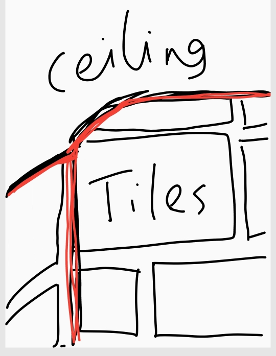

We tiled our bathroom walls a few weeks ago and the ceiling/floor has been sealed with silicone, but unfortunately the line along the ceiling looks really messy due to the ceiling not being flat. Rather than removing the silicone and redoing it, I'd prefer to attach beading over the top. However, part of the ceiling has a curve where the ceiling slopes down on one edge - I've drawn a (rubbish) diagram, the red line shows the edge the beading would need to follow.
Is there flexible beading available that will go along the full edge of the bathroom? Or will I only be able to use straight beading? Many thanks

If you are ok with quadrant beading then buy some upvc quadrant from one of the sheds and use this. You may have to warm the beading with a hair dryer so it bends to the required curve.
