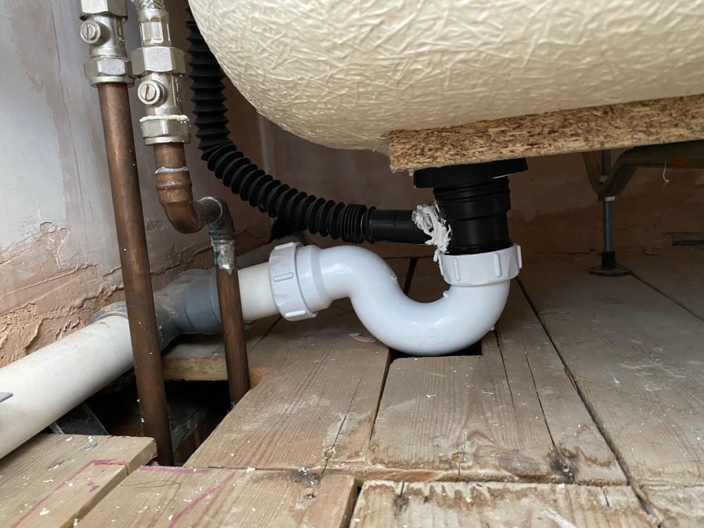

I know it's been a long time to post an update on this topic; however, I've finally managed to take a large cabinet off the wall that was preventing me from removing the bath panel and having a look.
In the photo included, the pipe on the left is the main drain that takes the sink and shower before the bath ties-in.
Do you think the shallow trap is causing the problem?
I also want to replace the click-clack as it's corroded. Looking in my local DIY store there appears to be sets that contain the click-clack, overflow pipe and trap. Would you recommend one of these or getting a separate (possibly deeper) trap? the combined sets I saw don't appear to have very deep traps.
This will be my first attempt at plumbing, I usually stick to electrics, so any help and advice you can give?
RM

by stoneyboy » Tue May 03, 2022 10:34 pm
Hi robm,
The poor installation of the existing trap is almost certainly the cause of your problems. Looking at the angle it has been installed the is very little depth of water left forming the trap.
You can either replace it with a deeper trap but you will have to cut out the floorboard or fit a new trap - mcalpine make a very neat top access click/clack trap which is fully adjustable. Suggest you use a flexible pipe joiner to connect the trap outlet to the existing waste pipe. It looks like the stub of pipe is coming out of a ring seal T so its angle could be adjusted.
