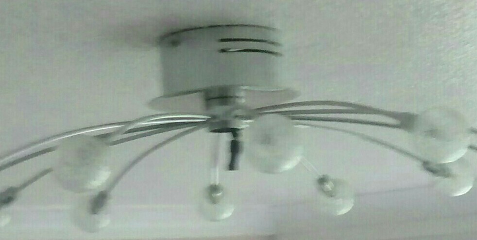

I'm looking for some advice on a light fitting that went pop. It tripped the fuse and is no longer working and looking to understand what may be the issue.
I've posted a PIC below and have not removed the fitting but wondered if anyone can suggest what the problem may be. I.e. is the a separate transformer or fuse in the metal housing above the light that may just need replacing or is a completely new light fitting required?

Step one remove all bulbs and re-try. If MCB trips with no bulbs then likely requires a new power supply. I would think twice about repairing as today extra low voltage lighting is a real problem.
The so called electronic transformer is not really a transformer, the electronics mean often a minimum as well as maximum output. This effectively stops the use of LED lamps.
Other than the bathroom I would not use extra low voltage lamps. Using low voltage (230vac) allows much more flexibility selecting bulbs. It also means one bulb blows at a time you don't get all bulbs failing together.

The light no longer trips. It doesn't work, none of the bulbs work but it doesn't trip the MCB when I switch it on.
I'm gonna take the fixture off tomorrow and have a look. I just wondered if there was a fuse or something inside the bulky bit that would just need replacing?

Likely it is a switched mode device with no user parts to change. Most auto shut down with short circuit and auto restart once removed. Likely G9 bulbs which can be got in a range of voltage and wattage.
I hate them as all too easy for some one to fit the wrong bulb.
