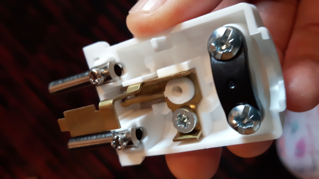

Hi there. I'm needing to learn how to wire 2 pin plugs. I have one that I've been practising on...but it doesn't have an obvious place for me to put the earth wire - whereas the one in the tutorial video most definitely did!! I'm a newby to 2 pin plugs so pls have a look at the pics and all advice welcome...Thanks.

The German "Schuko"; Type F plug is permitted in the UK, but only using an adaptor the German "Schuko"; Type F socket is not permitted as it does not have polarity it can be plugged in either way up.
We do have two pin plugs in the UK but these are only used with shavers or as a connector in line as with some lawn mowers.
The German Schuko (Type F, CEE 7/4 plug, CEE 7/7 plug) and the French (Type E, CEE 7/6 plug, CEE 7/7 plug) are very similar and there are specials which incorporate both earthing systems. It has both a hole for the earth pin (French) and the side contacts (German) but the German system can't be used with out British ring final system of wiring.
The the UK the 13A plug has a fuse in the line supply, for that to work line and neutral must always be on the correct side. With the German system there is a host of 16A MCB's similar to the old 15A British pre-war system. It needs more cable to wire it, it needs two pole switching on the appliance, it needs a far bigger consumer unit, and also the use of light cable for items which have a low power usage is not possible.
The 13A shuttered socket does not require any bits of plastic to stop children gaining access to live parts and they are all in all far safer then the German system.
That is not to say the UK system is perfect there is a possibility of overload where multiple items are plugged into one end of the ring. And the fuse built into the 13A plug has problems dissipating the heat when used for an extended time. But it is still far better than the German system.
However it does seem the German system is used in most European countries to some extent, only the UK has outlawed the German sockets.

Thanks for that. I am moving abroad hence needing to changefrom 3 pin to 2 pin plugs on appliances.

Because we have a fuse in the plug, we can use lighter cable than rest of Europe with small items.
0.5mm = 3A
0.75mm = 6A
1mm = 10A
1.25mm = 13A
1.5mm = 16A
As you can see only the latter is suitable for a 16A plug without a fuse. So it may be necessary to replace whole lead rather than just the plug. Since I only have British regulations to hand I can't tell you what is allowed in other countries. I would find a forum in the country your going to in order to ask the questions.
