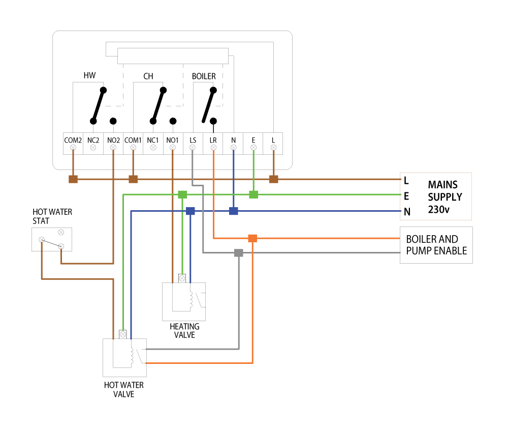

Good shout ... here is the Heatmiser wiring diagram ... I only want to connect heating ... thanks

You connect your new stat the same way your one is now.
Brown to Live
Blue to Neutral
Grey to com1
Black to NO1

Hi, I have similar setup as this the only difference is Black is A & Grey is B on Honeywell. So Black to Com1 and Grey to No1 on Heatmiser RF?

It would seem the CH and HW connections are not used with a combi boiler, just the LS LR N E L. So Black, Grey, Blue, Green/yellow or bare sleeved green/yellow and Brown.

Thanks for your reply, there is a earth cable terminate in the box so connect to the heatmiser earth terminal . The Black & Grey to LS &LR ?
