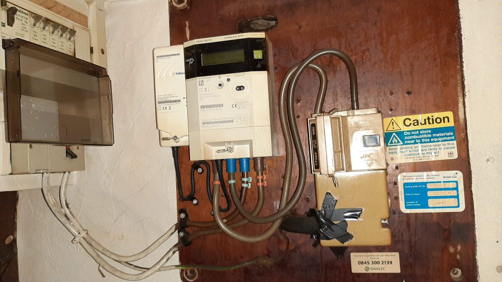

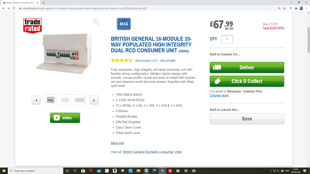

i may start some work this week can you take a look at photo`s of this new unit and my old unit i`m about to install
this unit from screwfix
also wanting to install a 63A MCB from this new unit to a garage unit with 16mm twin & earth cable
i`m having a problem finding a garage unit which will accommodate 2 x 32A MCB and 1 x6A mcb
reading up about RCBOs would it be better to use these in the garage unit

OLD UNIT
OLD UNIT
OLD UNIT
OLD UNIT
NEW CONSUMER UNIT FROM SCREWFIX

Looking at Screwfix website largest RCBO is 40 amp, type AC curve B 30 mA. I can't see any 63A RCBO's. And even with MCB largest is 50 amp. It says high integrity board, but would check on that, looking at British General CFDP16610 on other sellers web sites it does not say high integrity, what high integrity means is there are three neutral bars, so you have some MCB's on one RCD, some MCB's on other RCD, and also either MCB or RCBO which does not go through many RCD's so you can run steel wire armoured cable without RCD protection to a second consumer unit in your garage and that consumer unit will have the RCD for the garage.
One RCD could be removed in the main consumer unit, and RCBO's fitted in that side, but at £24 each that gets expensive, I paid £10 each for my RCBO's and still my consumer unit cost around £250 with surge protection and external isolator, a tad more expensive to the £68 you have paid. It was slightly bigger 18 module so with 2 for isolator and 2 for surge protection that left 14 RCBO's.
I made a mistake, I saw type B and thought the RCD built into the RCBO was type B but it referred to the tripping curve of the MCB portion of the RCBO and the RCD is type AC, not really what I wanted as I have some inverter powered equipment. Really needed type A.
So you could remove the RCD on one side and fit RCBO's maybe 3 RCBO's one for each ring final, and one MCB to feed garage, that's £72, then three RCBO's in garage another £72 plus the consumer unit, it starts to add up.
I went to local supplier (Link) and got a cheap CP (Electric) Limited board, as said £10 each for the RCBO's and they are available at 50 amp, I think price was before VAT can't remember exact price but under £250 and over £200 and included other bits like crimp pliers, cable, and external isolator.
The last house before we moved here had two RCD's feeding two fuse boxes, and from time to time they would trip for no apparent reason, it seemed to come as a batch with maybe two years between them, it was fitted late 90's so have had RCD protection for a long time, but over that time we have lost a few freezers full of food, so this time went all RCBO. One reason was lights split up/down and sockets split front/back so there is no way with just two RCD's that I could ensure lights and sockets in every room are on separate RCD's. And must have cost over £200 loosing two freezers full of food. Clearly did right thing as a roof leak did cause a RCBO to trip, but I could do without that circuit so no problem.
With the old dorman smith loadmaster I remember 70 amp MCB's, but not seen any over 50 amp with today's DIN rail mounted MCB's. As to if RCD in garage consumer unit or house consumer unit, both have plus and minus points, but with twin and earth not really any option, needs to be in house. Personally I would run SWA to garage unless integral.

if you look at my cu i have a isolating switch under CU
i would not need to draw the main fuse
ideally i would love to get rid of all those card meters
they are not needed any more i pay by direct debit

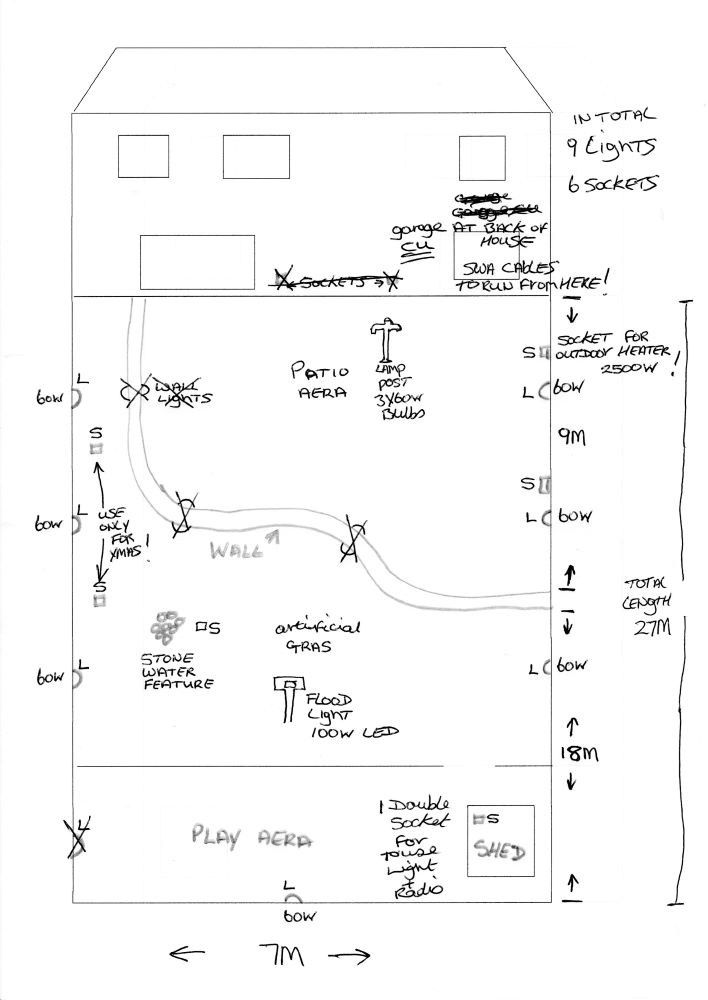

can you take a look at my plan hope the image works
i`ve taken out some sockets as perhaps are not needed
would these work comfortable with no overloading from a garage CU
as i would doubt that all sockets would not be used at the same time ?
would you say that the 63A MCB at main CU is to big and perhaps a 50A MCB would work
if the lighting to to big to work of 1 6A MCB i could install 2 6A MCB`S ?
1 for the fence lights the other for the flood light ?
i was going to run 2 x 2.5mm swa cable 1 direct to the shed just to add a light and a double socket i will not be drawing a lot of power from shed just the light and use sockets to charge phone or radio ( NO power tools ect,)
cable 2 was to power water feature and other 4 sockets

Looking at your plan it would seem 32 amp would be ample, think some of the lamp sizes are OTT, you know as a builder without planning permission 150 watt tungsten is largest bulb permitted in the garden, I have not seen any change to lumen yet, but really should consider 35 watt LED as the limit. You don't want to upset anyone as you really I assume don't want to involve the council, so keep within sensible limits.

for example cu in screwfix the MX looks good
but then again you would know which is best to use !
mcb`s or rcbo`s ?

hello ericmark can you take a look at this
i need some advice please
completed my building work and now on stand by bored !!!!!
why you ask i`ve taken all of your good advice
so contacted 7 local electricians well over 2 weeks now
not one reply !!!!
OK lock down
so as i`m now waiting on people WHO MAY NEVER TURN UP !!!!
I WILL NOT BE TOUCHING THE MAIN CONSUMER UNIT !!!!
so i`m asking for some help to assist a electrician if and when one turns up !
can i run all the cable outside
already bought 1.5mm 3 core SWA and 2.5mm 3 core SWA
i would like to do this work
if i connect all the cables tees to daisy chain the lights
leading to the lights then leaving all the tee joints exposed ( but sealed ) so if he wants can check my connections he can ?
should i run one 2.5mm to shed
or one cable for all 5 sockets and tee off from one socket to next ?
also the garage unit which will be installed at back of house
surely i can install this CU running all cable to the unit but not connecting them ?
so when an electrician finally arrives hopefully his work will be less
and i`m not hanging around doing nothing
so please can you help in what materials to buy or best ones to buy for example this tee from screw fix
Hylec TEEBOX IP67 MINI T-JUNCTION WITH TERMINAL STRIP (72715)
any good or can you advise what one`s to buy which you all have more knowledge than I
thank you Paul

hello all
fed up had 4 sparks around one said job to large !
had a lot of good advice but sorry to say no way i would pay someone over £3,000 so i have come down from my ladder so now just wanting to run maybe 4 socket outside and 4 led lights
can you advise on my new layout
my main CU unit is a crabtree 80A RCCB 30mA2 pole BS 4293 type SB6000 it has 2 spare slots
I also have a spare 32amp mcb
As I can’t seem to buy a larger fuse bigger than a 32 amp
My question is can I run a 6mm SWA cable from this 32amp
To this unit from the screw fix unit below
British general 5- module 3 way populated garage ( 1926G )
I'm now wanting to install this garage unit at rear of house inside !
Then run 4 outdoor garden sockets of the 32amp
And run 4 led fence lights off the 6amp
My other question is the 32amp mcb on my main CU
Good enough to run 6mm SWA cable to the screw fix unit
Been told to buy a 63amp for my CU but cannot buy any bigger than the 32 amp !
Thank you paul
