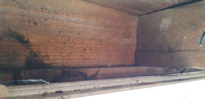

The photo of the underside of the flat roof shows what looks to be tongue and groove boards through which you can see the bitumen has seeped. So, I’m guessing the roof is simply the roof felt directly onto the T&G boards. When I put the warm deck on can I remove the existing felt and build up from existing T&G boards (i.e. vapour barrier, rigid insulation, overlay board, rubber membrane) or should I lay OSB3 board over existing T&G boards first?

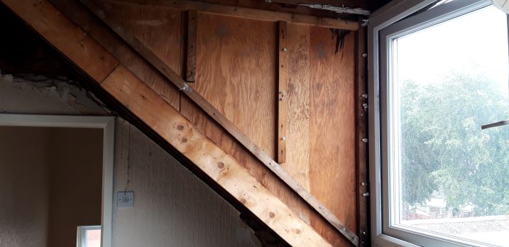

On the dormer cheek I could install 50mm of insulated plasterboard on the existing battens shown in the photo but that would only leave approx. 10mm of the window frame showing where the insulated board would butt up against the window frame which I don’t think would look right. The existing battens are 25mm deep, is it possible to remove those battens and bond the insulated board to the existing timber cheek board to allow for a thicker board to be installed?

Suggest you do not mix ventilated and unventilated roofs in the same property. Stick with a cold roof on the dormers and insulate below the rafters.
Use a higher thermal resistance board for the dormer cheeks so you do not seal against the timber used.
