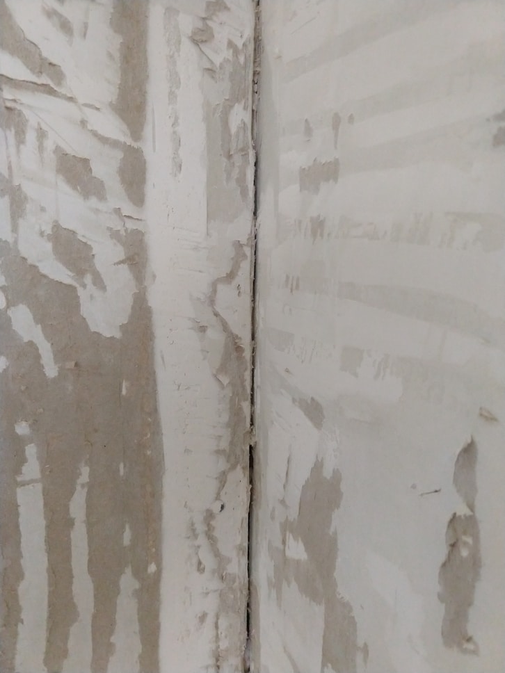

A couple more questions...
1) Where the two plasterboard walls meet at a right angle, there's a 2 or 3mm gap between them. Attached a pic showing this. Given this join will be right next the shower, are there any special precautions I can take? Or do I treat it the same as the other holes in the wall, ie. SBR, plaster, SBR?
2) When applying SBR before the plaster to the holes, do I avoid the existing plasterboard, covering just the breeze blocks?
Any advice would be great - I genuinely want to do this right, but details like these aren't easily found online or in books.
