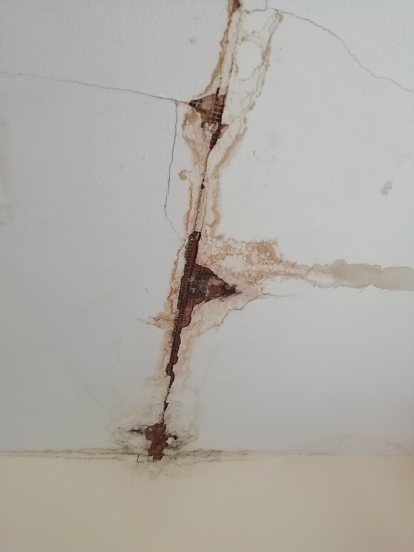

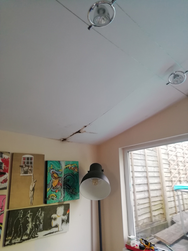

We have a slanted ceiling below a flat roof that has been damaged by a rainwater leak. The leak has now been repaired however the ceiling is damaged.
I have submitted a couple of photos to show the damage. Essentially the leak has removed some plaster and revealed a kind of mesh. I assume the ceiling is plasterboard and has come away a little, I'd say no more than 1cm, but does seem secure and looks flush with the rest of the ceiling. The line crack from the ceiling to the wall is approx 70cm long but area where mesh can be seen is approx 40cm by 20cm max.

I have also seen info on using mesh patches and plastering over. I don't want to do a simple fix that won't last but I'm wondering if this is a possible solution based on the info above? This does seem more time effective but there is little info on this and I also have seen reviews that a lot of patches don't stick well.
Any advise on how to fix would be greatly appreciated and if the patch idea is OK any advise on best place to get best patches would be great. Also, i have not done any plastering so pointing in right direction for simple stuff to use would be great!

Hi captainfurious,
In an ideal world the whole corner should be cut out and replaced. Since the scrim is still in place, remove loose plaster and bevel back the edges of the holes. Fill the gaps with plaster to 1or2mm below surface level, once this is set use a filler like polyfilla or tetrion to fill the remaining depth - you may need 2/3 coats with sanding between to get a decent finish. Coat with oil based stain block before applying your ceiling finish paint.
