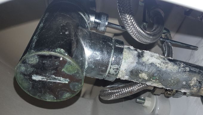

Any idea what are these green and white (mineral?) deposits around the chrome plated trap and pipe under the bathroom sink? I am replacing the basin with a new one and was hoping to keep the existing waste pipes but I have no idea if the current one is in good condition. No active leaks and it drains ok.
What can I use to remove/clean them?

Looks like the pipe is corroding through, has drain unblocked been used in the past?
