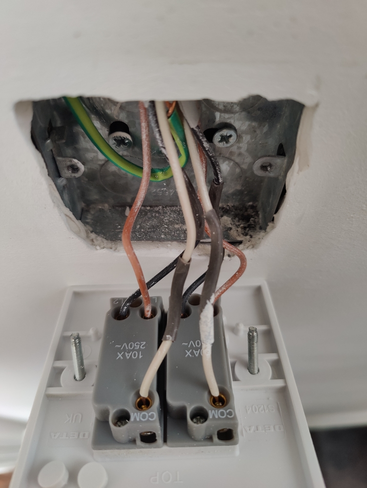

We've moved in to an bungalow with a bedroom loft conversion.

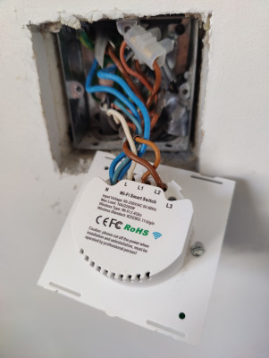

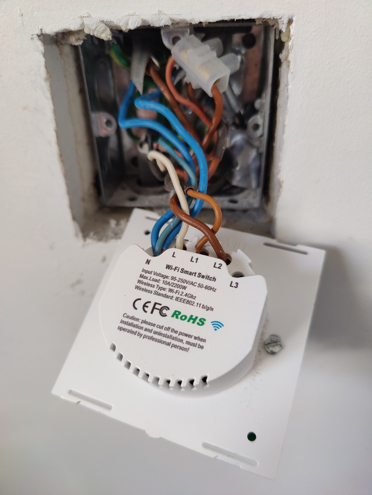

The upstairs light switch I have swapped for a WiFi switch which works perfectly. (First photo).
At the bottom of the stairs I've left on the original switch but now all that can do is cut the power rather than switching anything on. As you can see, downstairs is older wiring and therefore, no neutral wire.
I'm wanting to have a wifi switch downstairs, either instead of, or as well as, the upstairs one (in a 2 way formation)
What would anyone recommend? Right now I'm thinking of just buying a no neutral required downstairs switch and just getting rid of the upstairs one (we have plenty of voice control in the bedroom), however, I'd still need to know how to wire together the unused wires behind the current wifi switch.

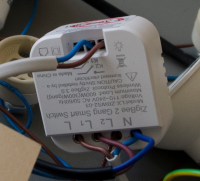

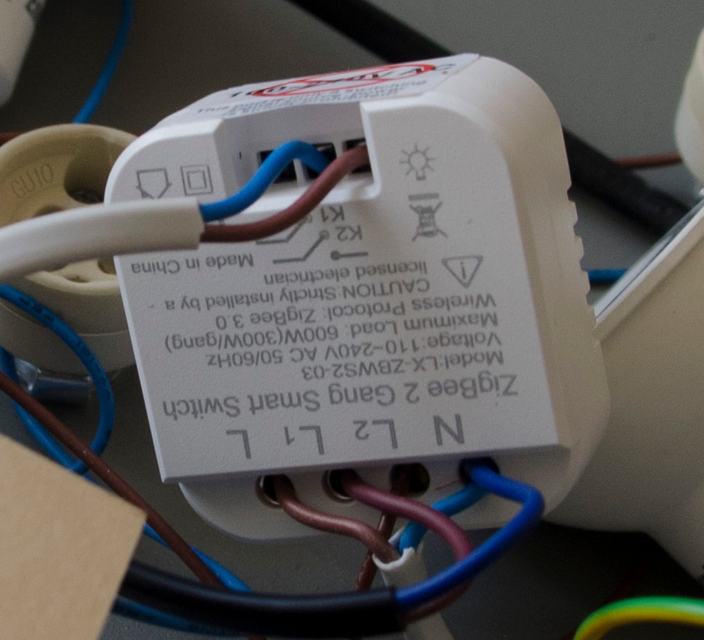

You need a relay in the lamp. [attachment=3]DSC_6061.jpg[/attachment] this is the unit I used, it is a twin relay, so I split the light into two outer and inner, the inner works with both wall switch and phone, the outer is phone only.

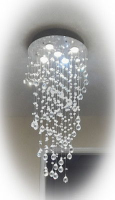

The lamp [attachment=2]lamp-landing_1.jpg[/attachment] has a colour changing bulb in centre, and simple on/off in outer, so I can have loads of light when I want it, or a dimmer lamp to see stairs without waking others in the house.

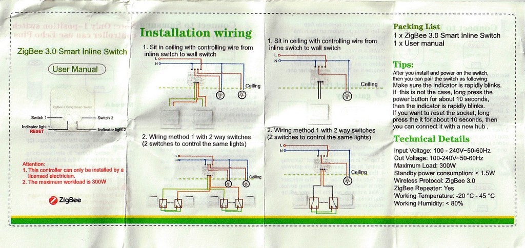

The instructions are here [attachment=1]Landing-light-relay-instructions1.jpg[/attachment][attachment=0]Landing-light-relay-instructions2.jpg[/attachment] the connection to switch is extra low voltage so can't be used if the line is shared, it is quite small, but will admit only been up for a week, so can't say how well it will last.

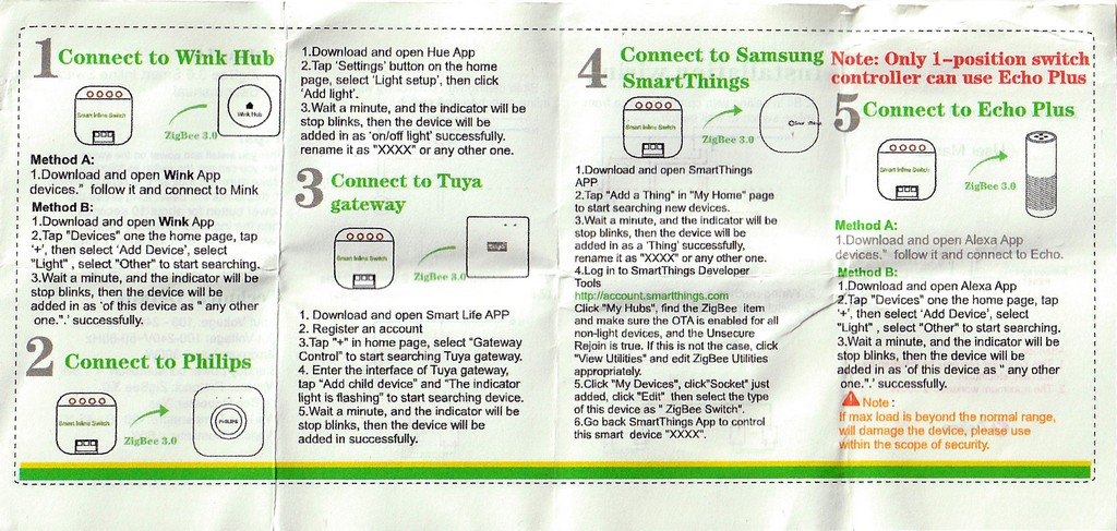

P.S. it used Smart life app, and a zigbee hub.

It sounds like you have come up with a workaround rather than having it fully operational at both switches and wifi. I think I'll have to do the same.
I can't put the current wifi switch downstairs because no neutral.
I'll look in to relays and lighting since I've never heard of that as a solution. Sounds a bit of an added complexion though!
