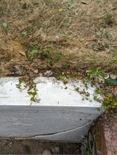

I want to add a row of bricks to a retaining wall. The bricks would be just one row with them placed i their side. The existing retaining wall is painted and in a bit apprehensive about busking on top of that. Any advice please?

Here’s a photo

And another image

Post by stoneyboy » Fri Jun 30, 2023 8:36 pm
Hi martcol,
PVA will not help. It looks like there is already a slab top on the wall so I don’t think adding a course on top will be successful. Suggest you find an alternative - how about oak railway sleepers?
