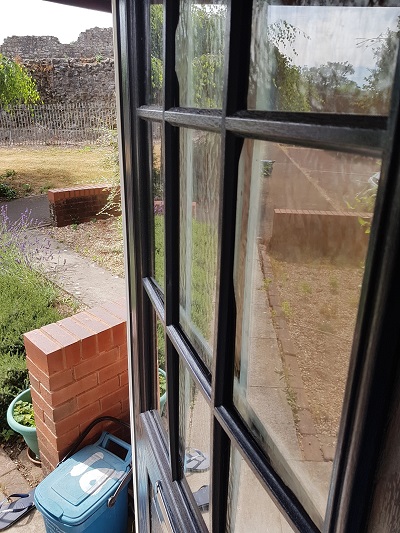

square strips on front door that are becoming unstuck from their adhesive pads
Hi , we have recently had double glazing and a new front door installed...
Whether it's due to the hot weather or not but the decorative square strips on the outside of the front door that are on the glass have began to come unstuck from the adhesive pads that attach them o the glass. Does anyone know what sort of adhesive this is and where I could buy it from? Picture attached
cheers
Mrredman
Joined: Sat Jul 28, 2018 10:11 pm
Re: Adhesive Worn off on Square Strips on Composite Front Door
by Mrredman » Sat Jul 28, 2018 10:25 pm
Take the bars off and clean all the residue using solvent cleaner and give the glass a wipe
Lay strips of double sided tape all the way along the bars and fit back onto the glass or just use clear silicone instead
