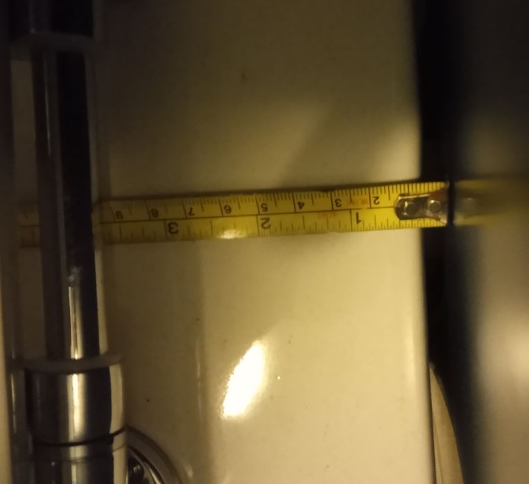

close up
close up

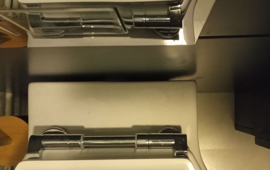

gap from above
gap from above
I have had a back to wall WC fitted - but there is a gap between the wall - a wood panel - and the WC. such that liquid can go down it - is this acceptable? OK? should I be asking them to correct this before payment?

poor finish - don't pay
Its not a massive job to resolve and it should fit properly
there must be an obstruction of some kind there because the process is pretty straight forward - push the toilet up against the wall, in your case as the wall is wood screw in - pulling it tight as you screw in.
Either there is an obstruction or a curve / lean in the wall
