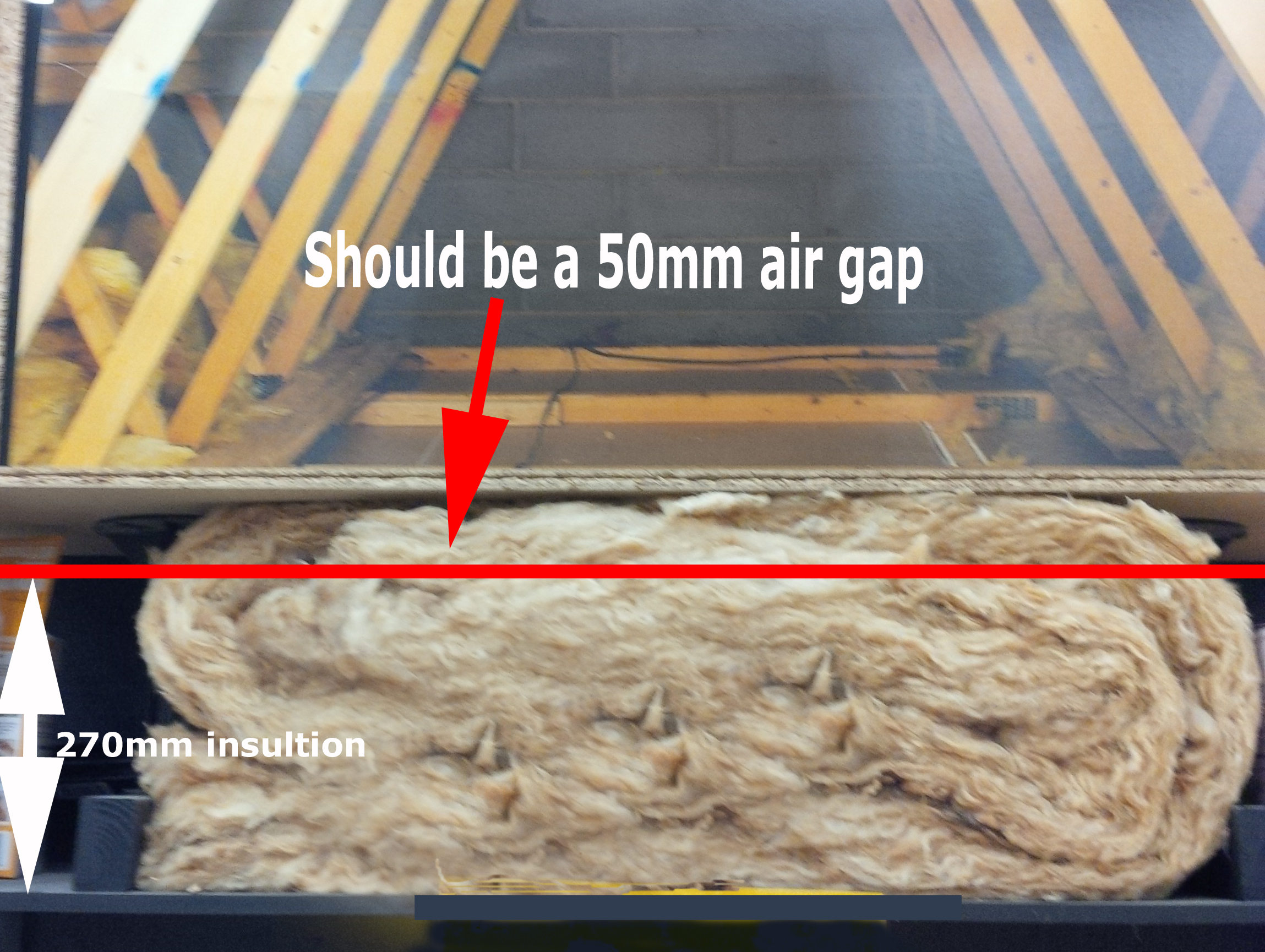

Guys, take a look at this image which was taken in a London branch of a national supplier of DIY goods and "uh-hum" help and advice?!
The insulation is so tightly packed into the floor void it is virtually useless and without a gap between the top of the insulation and the underside of the floor it will not take long before the consdensation starts either rotting the underside of the floor or dripping down onto the insulation from where it will filter through to rot the ceiling rafters and damage the plasterboard......Would you trust advice from these guys?

This isn't a great advertisment for how to insulate your loft well, but the guidelines only state that there needs to be 270 mm of insulation. It does not stipulate the size of any air gap required between the insulation and the loft boarding.
That said this is excellent practice to leave a sufficent air gap and will certianly reduce condenstation and potentially increase the effectivenss and life of your insulation.
