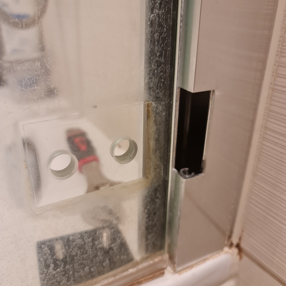

Hi everyone, Hoping to find some help as my bath screen has a hinge that has come out. The hinges appear to attach to the glass directly the top hinge is still in place and is holding the screen in place
the bottom one however has come out and I have no idea how to get it back in and secured there other than literally balancing it in place.
Any assistance would be great as I don't want to have to go through the landlord for something so small.

You do not show the outer part of the hinge but I suspect it has a hinge pin through the centre which is probably fixed in place with a grub screw. You may have to remove the wall bar to be able to refit this pin.
