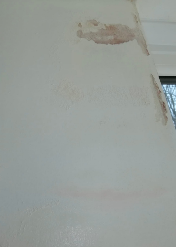

Good afternoon chaps,
This is my first time posting, I have an issue with some damp maybe. I'm new to the DIY game and recently I had my room plastered and painted.
I have a patch of wall where the ceiling if the bay window and adjoining wall have started to bubble and discolor after a few months of paining it.
I don't know what's causing it or how I can get rid off it. Any help would be golden.
Images attached
Harry

Update I removed some of the paint in the wall and found what looks like damp patches. Can anyone help

Did you work it out? I found a similar issue caused by my bay window guttering leaking - bay window guttering has a lot of sections and bends to a recipe for leaking.
It was resolved by my roofer who connected new guttering.
A good way to test it is use a garden hose on the bay roof when it is not raining.
