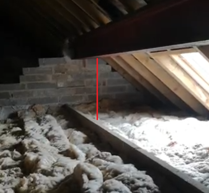

We have blockwork walls in our barn every 25ft or so that run front to back (the blocks are laid on their sides) and on top of them sit steels that support the roof. The steels run side to side and so are at 90 degrees to the blockwork that supports them.
I need to remove some of this blockwork to put a doorway through on the 1st floor. There is nothing above the blockwork I wish to remove but how close to the lintel can I cut it back? How much overhang do I need to leave the lintel sitting on?
They say a picture says a thousand words, how close to the lintel can I cut the red line?
Thanks.

Hi markandcath
Provided the wall is 450mm thick you should be ok removing the wall 500mm outside the edge of the steel.
This assumes that the wall is soundly built and appropriate foundations are in place under the load centre. It’s probably worth getting a structural engineer to have a look before you start.
