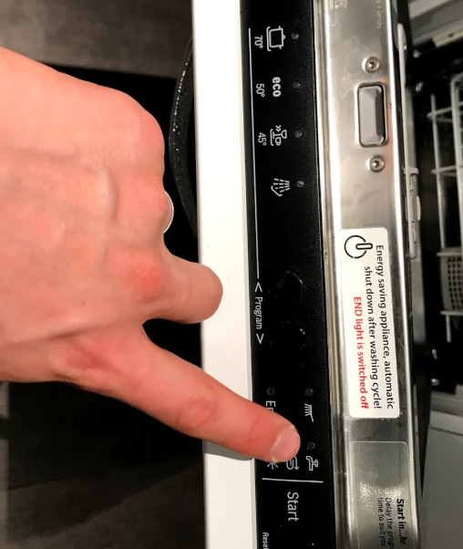

We started having an issue with our dishwasher today. The "Check tap" light started flashing (shown below, minus the flashing light)
According to the manual, this is an issue with the tap or draining.

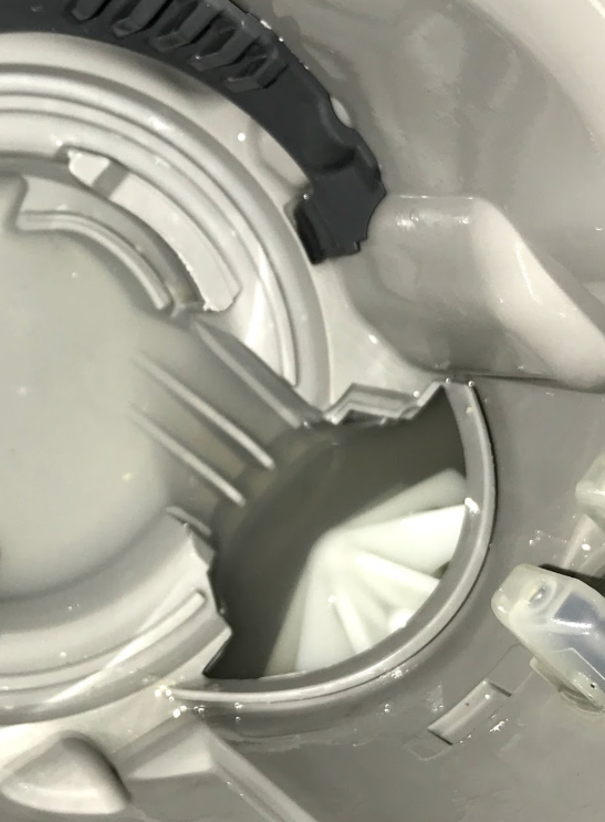

I checked and couldn't find anything clogging the drain. The water level looks like this (maybe 1-2 cm of water)
Water level
Water level
If I add clean water to the dishwasher and turn it on, it will drain down to about this level, which makes it me believe it's not blocked.

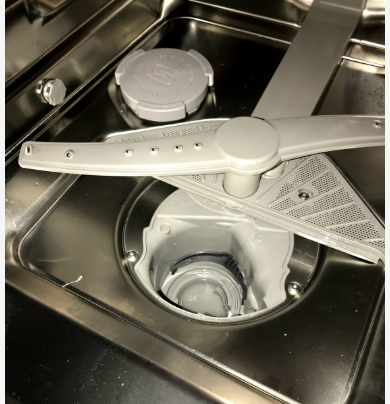

I opened the cover and checked for any debris and turned the impeller to make sure it can rotate freely.
To give you an idea of the water level, the impeller is about 90% submerged in water.
