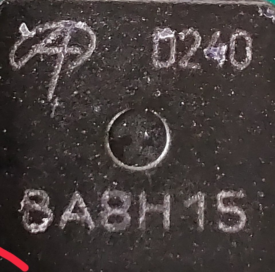

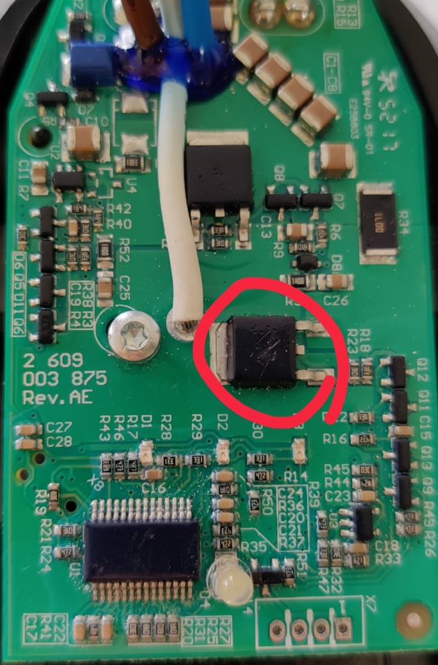

Hi, I had the same problem. Turns out that the MOSFET used to switch the voltage to the battery blows up. I did manually bypass the MOSFET to check, the motor works for a quick second and stops. Stopping is due to overheating protection since I'm using it with max current (bypass of MOSFET). I'll look for a replacement tomorrow since it's Sunday today. The component is AOD240. Images attached.
