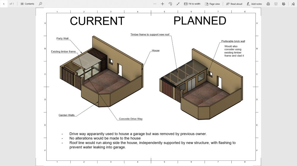

I am planning on building a garage in my garden, roughly 15-16m sq.
It already has a concrete slab, with double gates so is pretty much asking to be made into a garage!
One side of the garage will be against my garden party wall, and one side will be up against the side of the house, the remaining wall and roof is what i am planning on building. No alterations will be made to the house (doors through etc).
It is stated that attached garages are classed as extensions, and as such require building regs. To get around the requirement of building regs - would I need to separate the garage from the house by a fraction with another 'wall' (sheet metal or whatever i chose?), or would this be exempt from building regs as planned - butting up to the house?
