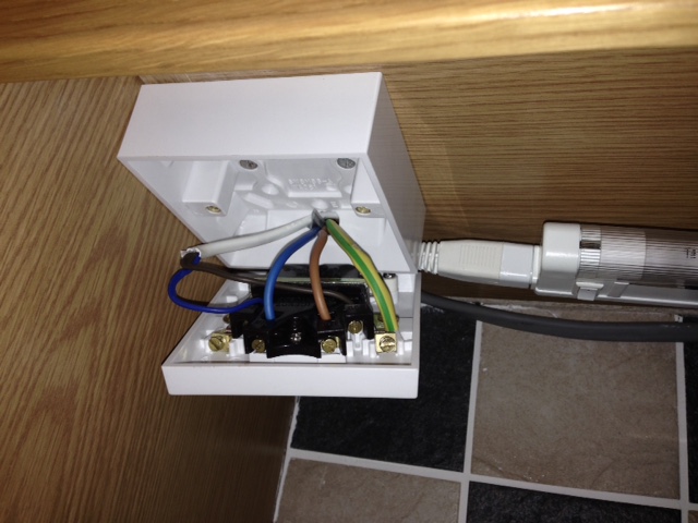

Existing socket wiring to lights under the kitchen cupboards
Hi everyone, help needed please
I've attached a picture of a switch which was added to power the lights under the kitchen cupboard (2 of them)
I want to add a plug socket to provide extra power for my wife's bluetooth speaker, as the other plug sockets are across the other side of the kitchen
Can this be done using a junction box from the existing switch and then from there to a surface mounted plug socket...or have I missed something or is there a better way??

Of the fused side i.e. with wire to light you can add, but not to unfused side.
Likely the fuse is rather small so it may do speakers but not much else. If it were me I would replace the back box with a double back box, then use LAP grid switch modules to build up what I want. However that means some wiring, it would allow two fuse holders and two switches or blanks. If the unit does not switch the light then using the grid system you can get two fuse holders in a single socket box.
In theory you should supply one fuse from the other so total max is 13A. But since light fuse is so small I would wire feed into both even with 2 x 13A fuses it's no worse than a double socket.
