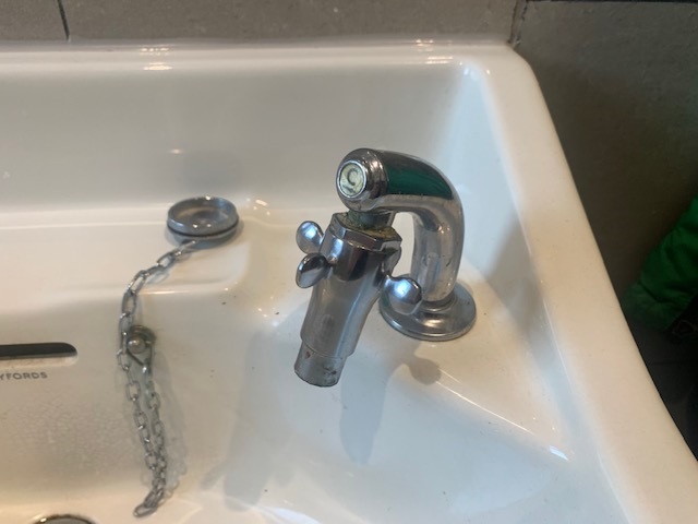

Does anyone recognise this type of tap? I want to replace the washer to fix a dripping tap but can't find a way to remove the head.

Hi luigilou
Grip the nut at the top of the coned bit and unscrew the winged bit.
