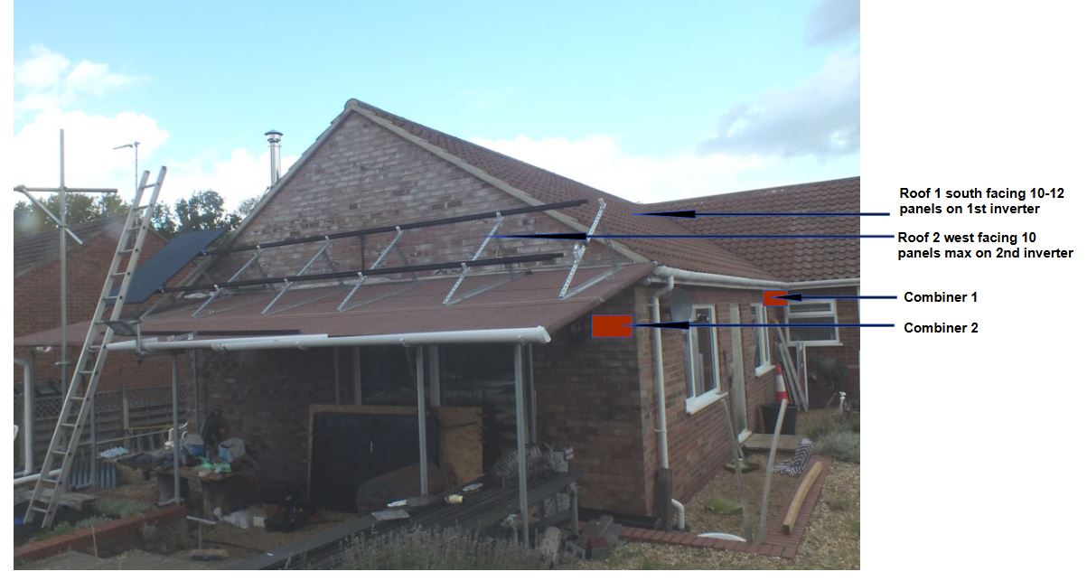

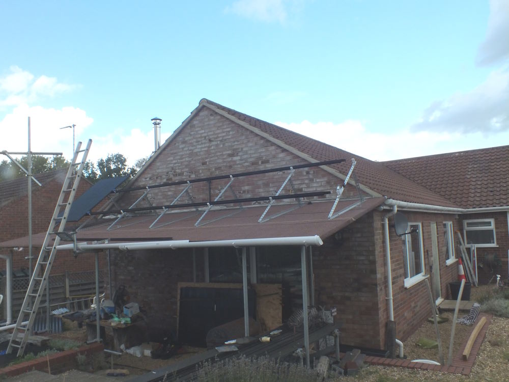

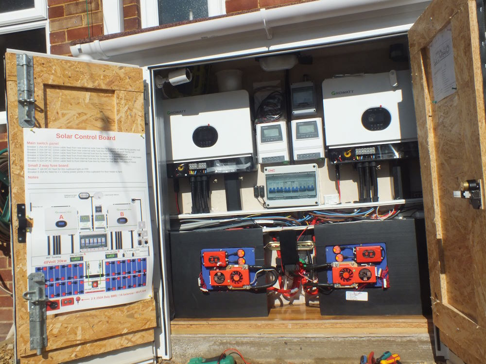

by collectors » Sat Sep 13, 2025 3:46 pm
Hi, sorry, yes kwh. Here is a couple of photos of the project.

Very true, but also iboost+ does not "Switch" on/off, it controls how much goes into the immersion heater, which is often less than 3 kW.
You will need either a G98 or G99 form needs completing and submitting, I think G99 in your case as over 3.68 kW, and then you get the MPAN export number. You must not mix up kW and kWh on the forms.
