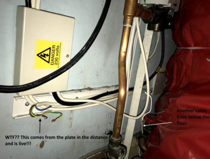

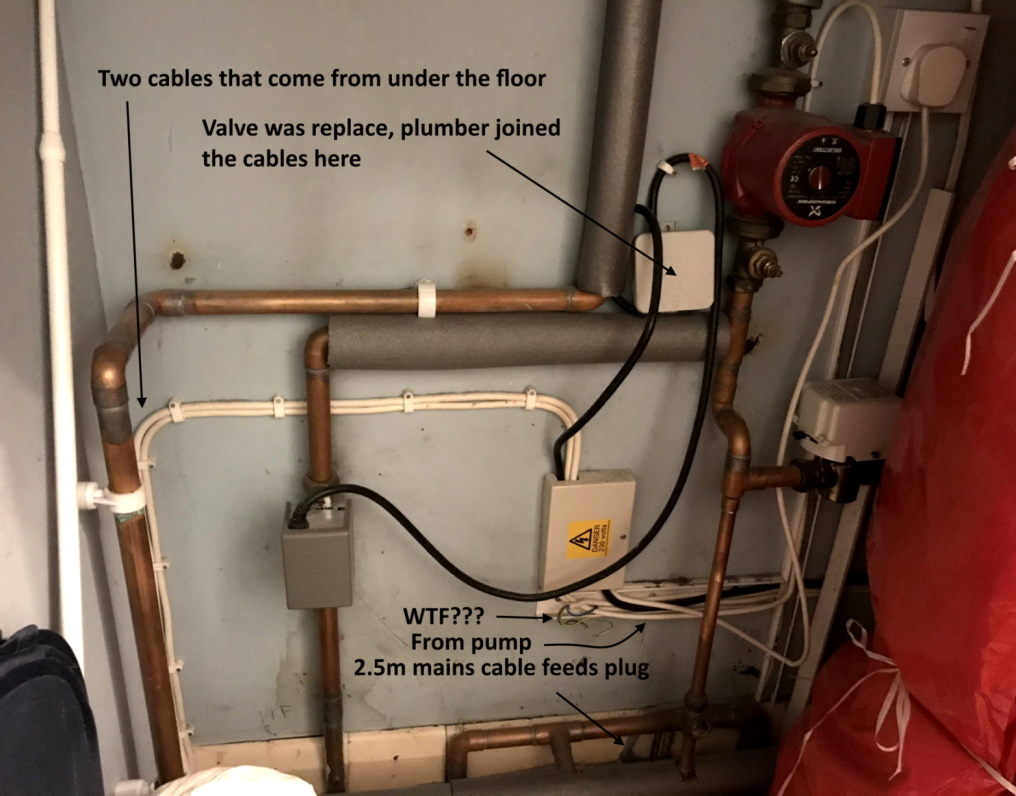

I've had PV solar panels for a while now and finally brought a solar iboost to divert the excess solar generated towards the immersion heater. I'm fairly confident when it comes to diy and electrics but with this, I'm stuck. I feel like I have more wires than are needed and it just doesn't make any sense. How and where can I install my iboost system, and most importantly, how can I make my system safe?
My house previously had a back boiler which was removed 20+ years ago. It looks like I have an S plan system with two valves (one HW and one CH), and I have a Hive active heating so no thermostat on the wall.
In the airing cupboard there is a plug socket and the plug in the socket powers the wiring centre (that can't be right can it?). If I turn that off, it obviously turns everything off.
Rather than going to its own fused spur my immersion element has a standard 3 pin plug which I'm assuming if the central heating system went down I could just swap over and get hot water (never needed to do that).
There is a blank plate to the right and inside is a chocblock with one cable coming into the back of back box and the other exiting the left side (as seen in pic). This cable is live and when I took the conduit face off I found the other end just hanging there!!!! WTF!!!.
There are two white cables that come from under the floor to the left, and another that's behind the tank which goes to the central unit. Sorry the camera angle was bad so I drew the cable in the pic.
I've uploaded a video of the mess. https://youtu.be/vCJqviFU04A
Any ideas are welcome.

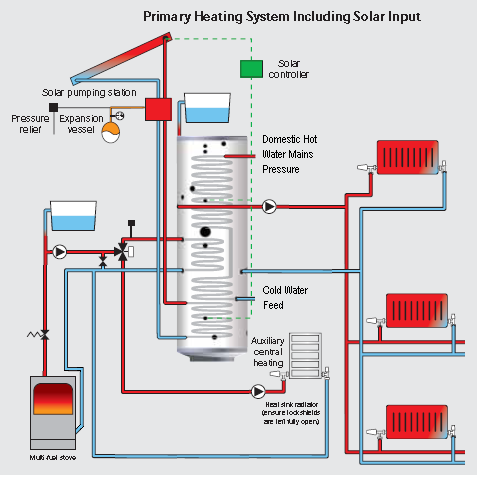

There are systems like this [attachment=0]Torrent pipe example.PNG[/attachment] where multi energy sources combine, but the heat store may use water but is not a simple cistern, it is rather special. But for what you have can't see how the central heating has any connection with the iboost the only connection is you likely want to keep water at 60 degs only with central heating so there is an option for the immersion heating to lift it to 80 degs.

Done some more research and I’ve got a dual channel system which is the two white cables that come up from the left.
It looks like I’ve got a 12 connector block where ‘normal’ diagrams only have 10 and the L, N and E are in the incorrect order.
Any advice on how to wire the iboost?
