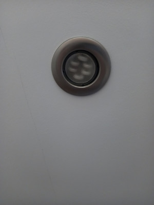

Thanks for your reply. I have attached photo. I realise they have been superceded by LEDs but hoping I can still buy them if I can identify the type. I understand there are 2 pin and 4 pin but not sure how to tell which one I have.

You have been looking at the wrong information. 2 pin or 4 pin refers to the "2d" fittings. What you have has a GU10 base (Just twist) as it is a CFL it is obsolete

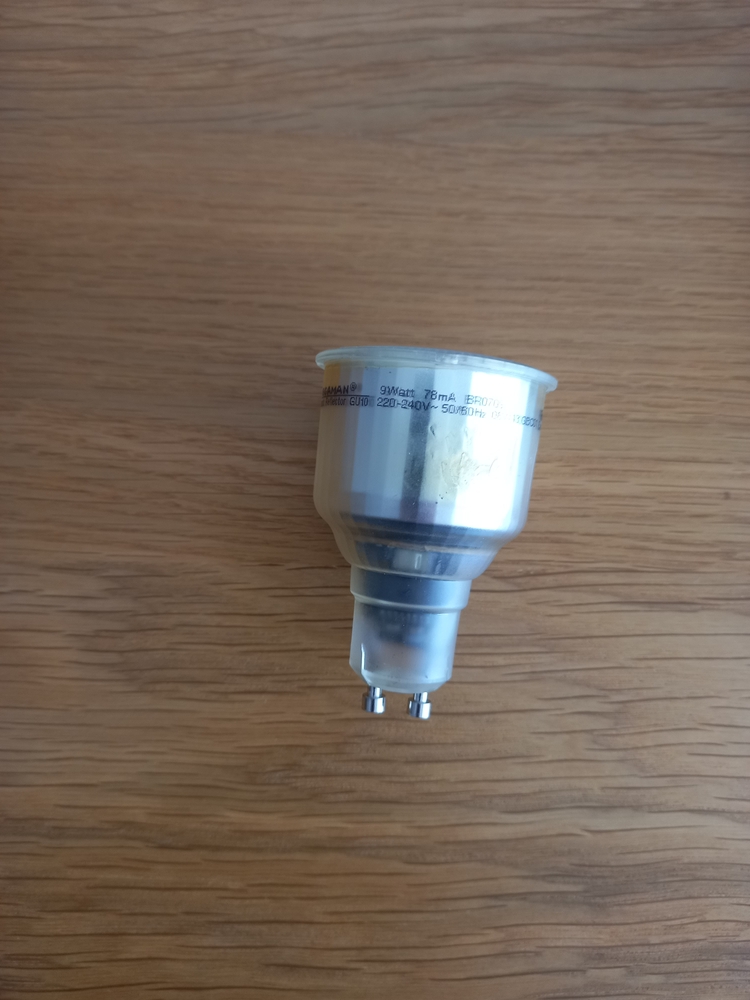

At last got one out. Photo attached. 220-240v 9W 75mA. Looks as though I need long form replacements

Just to wrap this up. LEDs arrived today. I decided to replace them all with LEDs. Much better light now. Thanks for your help with this.
