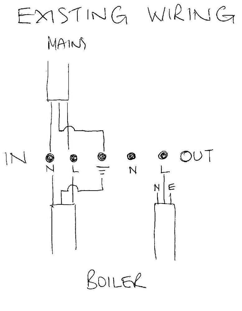

I am attempting to change a LAP mechanical timer - I believe the model number to be TM1H24-XD - for a Drayton LP111. The timer controls the heating side of a combi boiler.
I am having trouble with the wiring connections. The existing wiring has two cables from the boiler to the timer, one has 3 wires (L,N,E) which connects to the 'IN' side and the other has only one wire (L) which is connected to the 'OUT' side, the remaining cores of this cable have been cut short.
My question is, how would thes wires be connected to the Drayton unit, which has 6 terminals. Left to right N,L,1,2,3,4. I believe terminal 4 is a spare.
My thoughts are that the feed from the mains will connect to N,L plus earth. The boiler cable with 3 cores will also connect to N,L and earth. Looking at the wiring diagram provided by Drayton I need then to provide a jumper from L to Terminal 1(common). The problem is which terminal does the single core from the second boiler cable connect to?

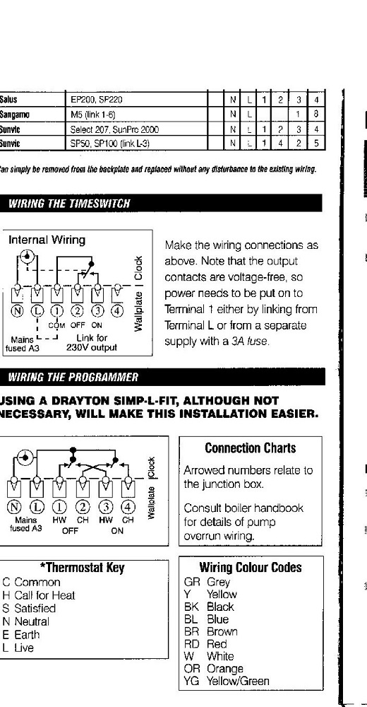

This is an extract of the Drayton instructions which shows the connections required

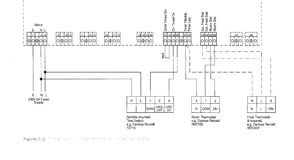

This is the applicable wiring diagram for my boiler. Its a combi and I am only looking to control the heating from the new timer.
This is my sketch of the existing connections between the boiler and the faulty mechanical timer.

According to the diagram, the single wire you have should go to the terminal they marked it as "ON / call for heat" Terminal 3

Thanks Mr White thats excellent. I would still need to provide the jumper to T1 I am guessing as per instructions.
Thanks again
Posts: 1418
Re: Changing a Mechanical Timer to a Drayton LP111
by Mr White » Mon Jan 14, 2019 5:55 pm
You are correct, you would still need a link from live to T1.
If it helps you, what you have is an electric switch but nothing to actually switch. By adding the link from Live to T1 you are providing something to switch (The live) and the other single wire (T3) is where it will go to when the switch is operated.
