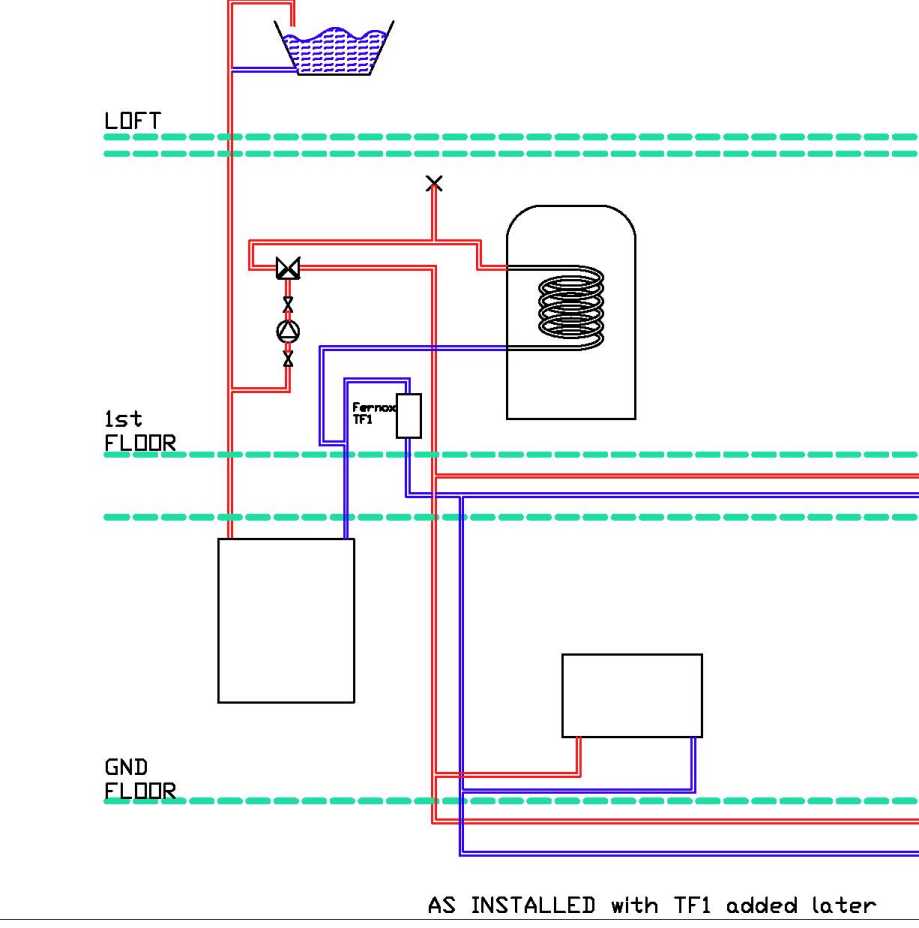

It would save me a lot of faff if it was acceptable to combine the feed and vent in the manner shown in diagram below.
Or should I resort to separate pipes for each, as small sketch.
I would welcome your comments
